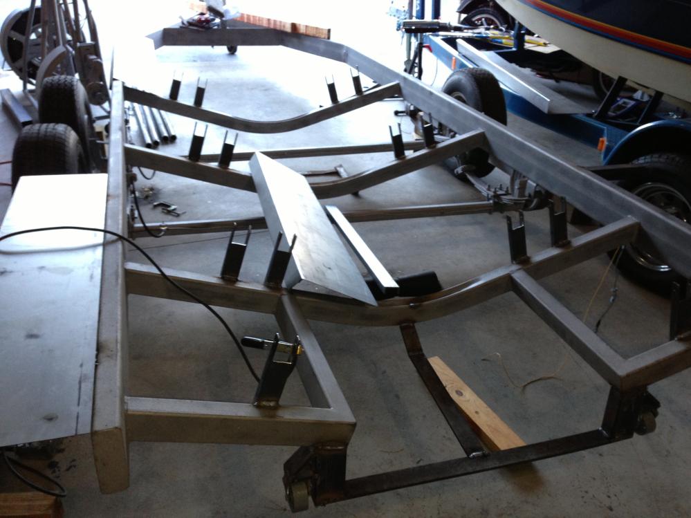

    I've torn into my derelict saltare trailer. The previous owner left it outside for several years... sheet metal was rusted badly, it was just best to cut it all off. I also cut off the bunks and the bunk support steel as it was too rusted to salvage. The prop guard and front cross member were bent, so off they came too. Here is what was left:
    summer 2013 Family pics 662.jpgsummer 2013 Family pics 681.jpgsummer 2013 Family pics 682.jpg

    After sandblasting and ordering new fenders, sheet metal, tube and plate steel, here is the latest progress:
    c-channel bunk supports cut, drilled and welded on:summer 2013 Family pics 683.jpg
    and a new prop guard with wheels to assist on those steep areas where the trailer would bottom out:

    and to please my wife, removable guide posts, that pin in. (When we go out in the upper hudson, there are no docks, i back in the trailer, she drives the boat on)

    So i ordered paint from eastwood, epoxy primer and catalyst, black. Cribbed the trailer up 3' and spent 4 hrs spraying on the primer with a HVLP gun. Was very pleased with this product, covered well, used about 1/2 gallon of paint and activator total. (It comes by the gallon and you mix the activator 1:1). Dries quickly providing a good base for the blue urethane final coat.. more pics to follow.
