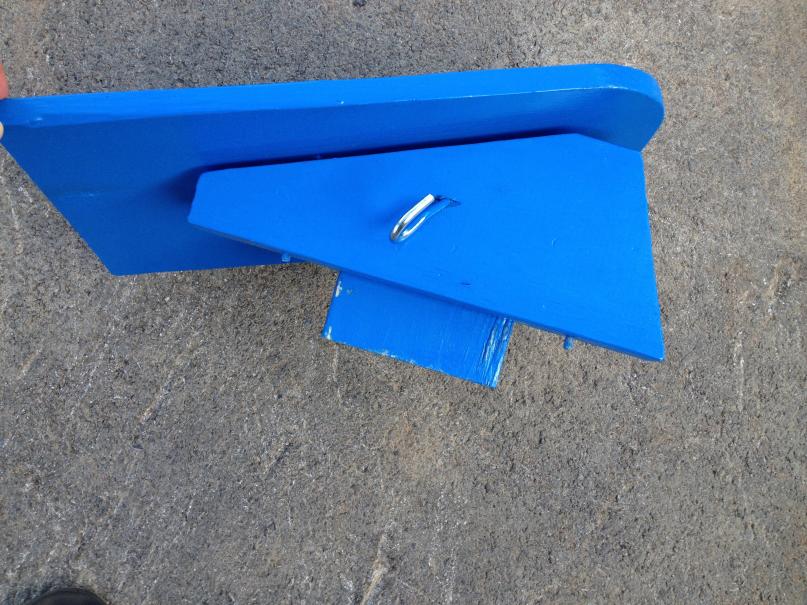

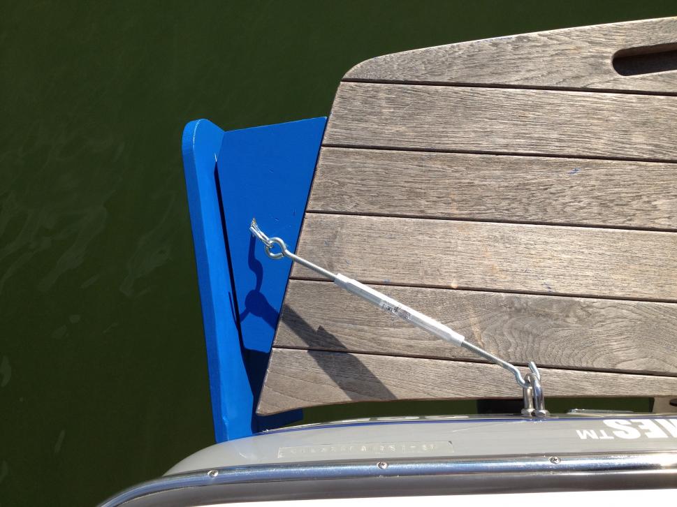

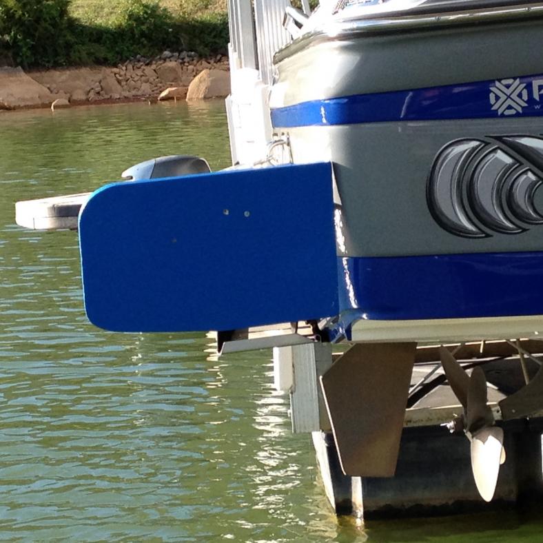

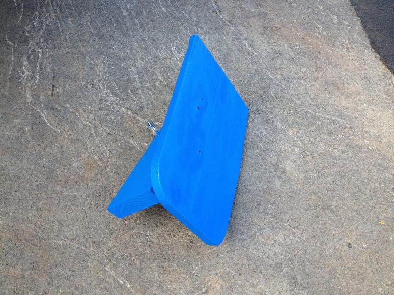

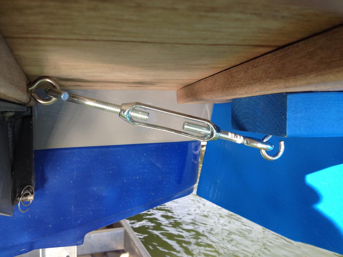

    Built my own DIY gate based on all the info from all other threads and DIY'ers. very easy, inexpensive, comes off in seconds, no drilling in hull.
    shelf board(oak), scrap 2 x 6 (2pcs), eye screws, and turnbuckles

    wake looks great, and a simple install. nice work!

    Looks simple and effective. Good job. My question is what if I have the fiberglass platform. I'd like to try this out but what would I hook the I hook to under a fiberglass platform? My boat is an hour away at the moment so I can't look under platform at the moment.

    Dimensions are 18 x 11.5 which tapers to 10.5
    About 22degree angle
