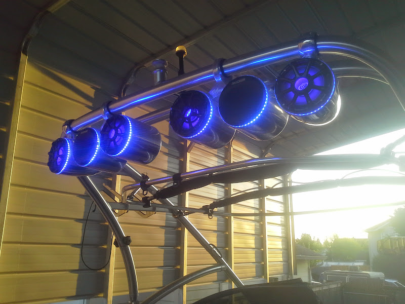

    I got mine for a lot lower than retail. My boat already had 4 cans with Polk Coaxials, so for $200, I was able to replace those with a closeout deal on the KM6500.2 drivers. Then later on, I added two more cans ($140) and another pair of the midrange speakers ($100). SO all in, I'm at $440 with re-using the Ariel enclosures that I already had.
    Since the speakers were previously wired using 4 channels of power, I was actually able to repurpose some of the existing tower wiring. I went from a 4 channel amp to using a 2 channel amp at 2ohms. so it only meant I needed 4 of the 8 conductors. I used the "extra" wire to add LED rings and LED cone lighting to my speakers. I think it came out fantastic.
    Still probably more money than yours, but pretty good for using off the shelf proven marine grade components. I've been told that my setup is equivalent to a pair of the 8" HLCD speakers (like the WS Rev8 or the Exile XM9)

    Nice setup, leds make it even more crazy !
    How do you deal with filtering/connexion ?
    I saw filters on the rear of compressions, but how are filtered woofers ? Do you use 2 channel amp for comps, and 2 channel amp for woofers ?

    The mid-bass woofers also have their own passive cross-over. Each component has a 4 ohm nominal impedance. The bass KMS67 setup includes a pair of mid-bass woofers and a pair of Compression drivers. This setup is designed with the intent that a mid and a compression driver will be wired together in parallel, but they can actually be run as individuals. When each mid- and compression driver is wired together, the cross-overs allow for the nominal impedance at the amp, to maintain at 4 ohm. This makes this setup ideal to bridge on a 4 chnl amp or a typical 2 chnl stereo. When a pair of the extra mids, for which we call the "6-Pack" is added in and wired in parallel, the nominal impedance drops to 2 ohm. At this point, a 2 chnl amp or a 2nd 4 chnl is the ideal setup.
