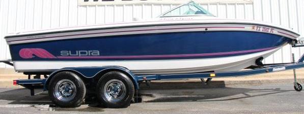

Congratulations on your purchase. I also own a 97 Sunsport, had it since 99. Engine hatch is easy to remove... Pull it out of the boat... There are two screws that hold the rear floor in place. Remove those screws and the floor will come out. The rear sear has a couple of screws in the bottom holding it to the floor. I removed mine years ago and did not put them back in. The seat fits tight within the gelcoat on both side and the the rear cup holders. It lifts out very easily and gives full access to the fuel tank. The rear cover in the ski locker gives you access to the fuel gauge sender. Mine does not have the shower option. I do have the GT-40. What color scheme is yours? Enjoy!!!!
Thinking about adding a tower to it
