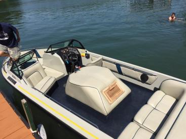

    I just purchased an 89 conbrio with only 230 hours on it. Boat is beautiful and in great shape.
    The only problem I have is sometimes when starting:
    When I turn the key = nothing.
    I engage the transmission knob put it in reverse.
    Return to neutral.
    Disengage the transmission knob.
    Now she starts fine.
    Any ideas on what I need to do to fix this.
    Thanks!
