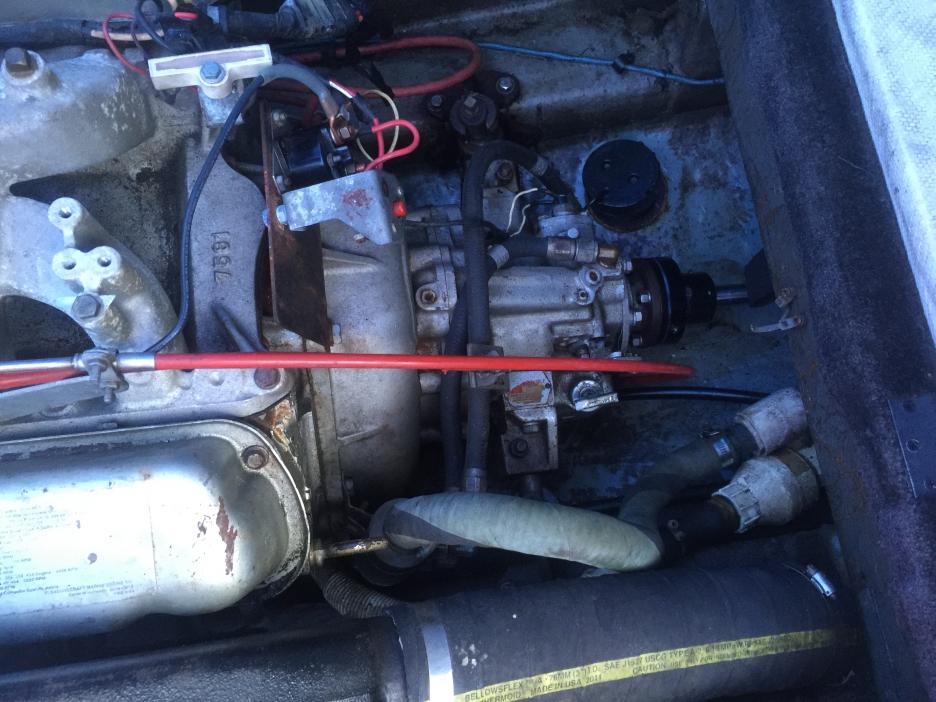

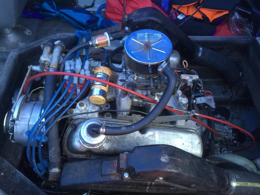

    Post a pic of the engine from a few angles. I might have an answer for you.

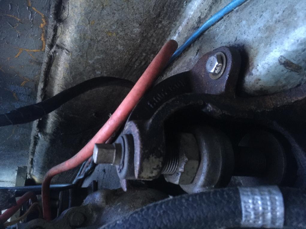

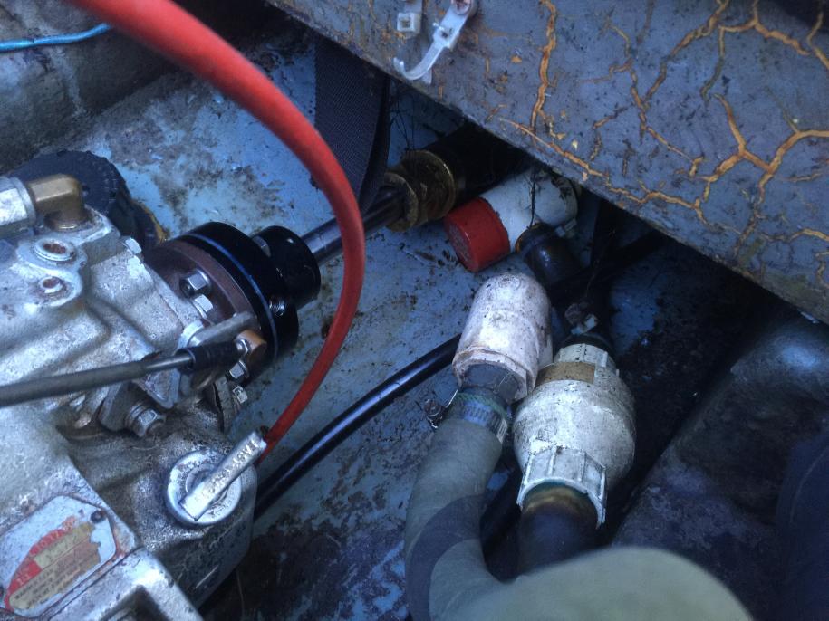

    Hopefully these might help? Also if anything dosent look right please let me know! I'm not an engine person
