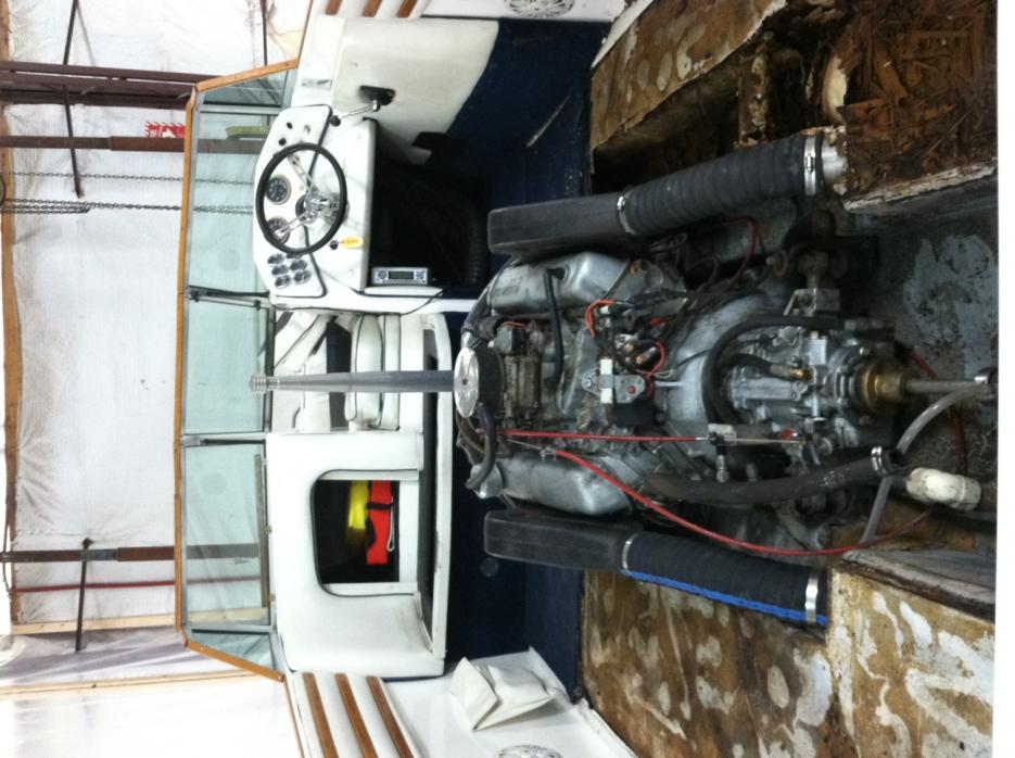

    Sorry to hear about your luck, I may have made a similar "blind purchase" and have already started to tear out the floor and waterlogged foam....
