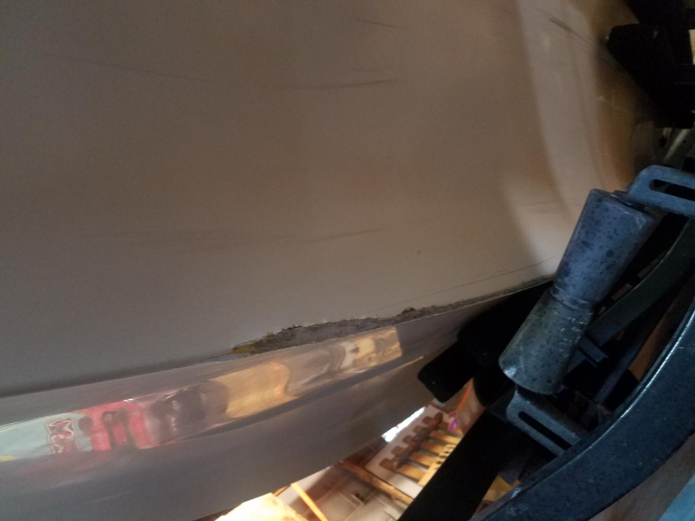

    I found some rocks while exploring a new-to-me lake. I'm ecstatic that it was at idle as opposed to full speed, but there is a lot of inertia behind a 23' boat with 6 adults on board, and KY limestone doesn't give. I've got some minor scars to the keel and two trashed fins. I'm looking for someone that may be parting out a boat, or if anyone knows of an aftermarket source for something close - my boat already has an aftermarket rudder and port, and driveshaft so i'm not tied to keeping it original in any way. option #3 is send them to a prop-shop for repair but I'd rather just bolt on something new if possible. My nearly new Samsung S7 (designed to be water resistant) failed and let water into the camera lens earlier the same day, so no carnage photos to share.

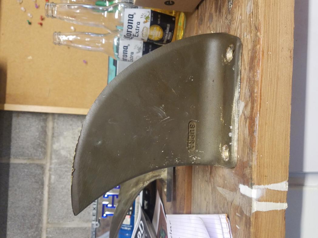

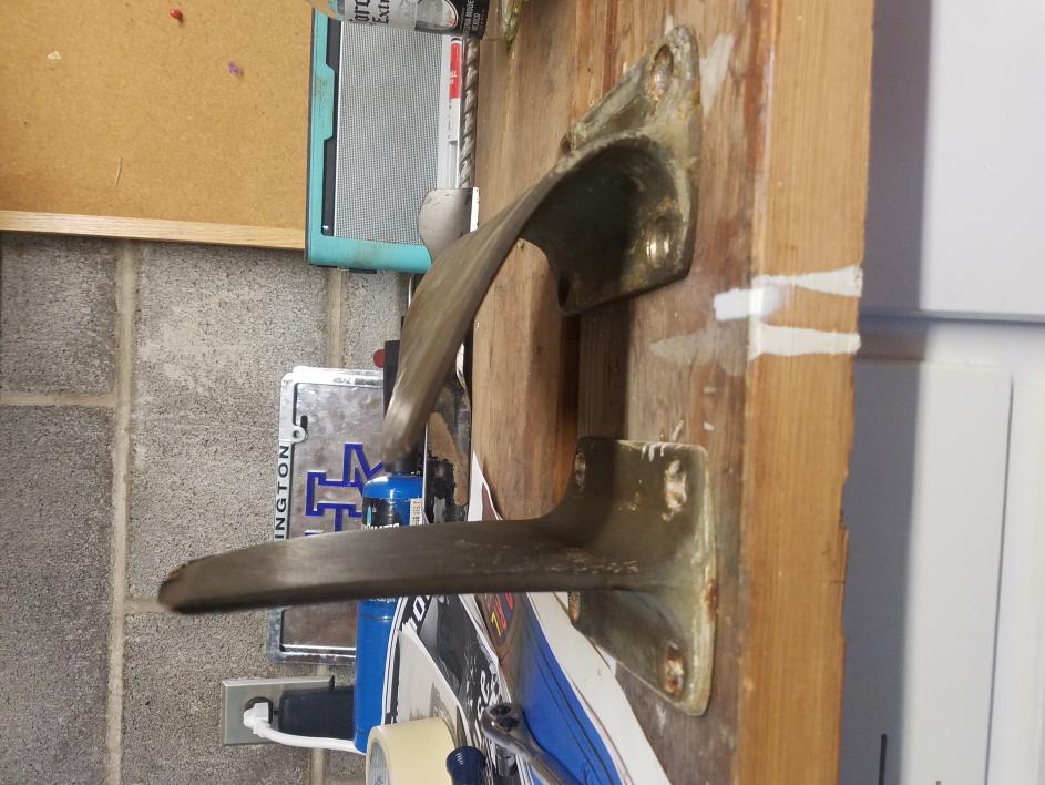

    Haven't called marine hardware yet, wanted to inspect and get dimensions first. Carnage photos as promised.

    Those look like they only need a little light buffing to bring them back...

    That's a heck of a bend. Any damage to the hull where it mounts? I recall the hull is very thick from when I drilled for my paddlewheel. If not cracked plan B can always be to heat and straighten, clean up with a grinder.
