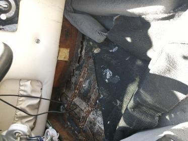

    My first concern is the floor. Everything seems solid on the Port side of the boat. The Starboard side, under the steering wheel is a mess. Looks like a repair was mickymoused. Behind the drivers seat, there is a couple of soft spots as well. The stringers still felt pretty strong when i checked the bolts on the motor mounts. Obviously its hard to tell anything until the seats and carpet are out.

    Here are a couple photos. As you can see the area under the steering wheel is definitely in need of attention.

    We've all been there hoping it's not a total rebuild but the sad truth is...it is. By the time the deck is rotting in the middle of the boat the bottom of the stingers are shot. Your foam is trapping water. Would be throwing good money after bad to piecemeal a patch job.
    Another vote to use it for the season if the motor mount bolts are holding firm. Slap some plywood over that area under the diver's dash. It's a low traffic area. You wouldn't be the first or the last to do this (I did it behind the dog house for a season or 3). Save the rebuild for next winter. Of course that's if you were hoping to use the boat now versus working on it for a couple months first.
