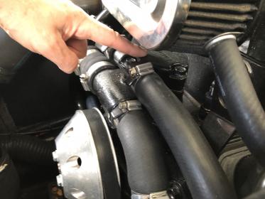

    I replaced the impeller today and it seems to have helped. However, I think it is running a little warm still. The air temp was 80 degrees today and the water temp was 63 degrees. After installing the new impeller the engine temp fluctuated between 167 degrees and 153 degrees as I varied my speed from 3200 rpm to idle. However this still seems a bit warm...anyone have thoughts on this? The existing thermostat is a 160 degree thermostat. I may change the thermostat for good measure. Could anyone point it out in the picture below.
    Also, I took off the engine cover (is this the manifold cover) and in order to do this I had to unplug the electrical connection shown at the bottom of the picture. I was hoping to get a better view of the where the rubber hoses come together at the top of the picture to see if this is the thermostat location. I put everything back together and went out to test impeller. At one point I idled down and the engine sputtered and stopped. it has never done this. I took a look at the engine and realized I did not plug the electrical connector back in. I reconnected it and started the engine and got a Service Engine warning on my dashboard...UUGGG! I continued to test the impeller and the boat ran fine however the warning didn't clear. Does anyone know what the electrical connector is? Could this have caused the error code? Is there anyway I can clear the code?...thanks for any help...John

    I would not worry about your temperature or the thermostat at this point. Your engine temp is well within limits and you are looking for an issue to solve where there isn't one now. The thermostat is working and functioning properly if you are seeing a temperature swing like you posted above.

    Here is thermostat location.
    Mine runs 160 all day long.
