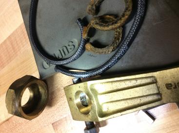

I’ll take a few pics for you as I plan on replacing my packing today in my 91 comp. Basically the threaded stud that you have the nut removed in the picture has a wedge shape cut into. I sprayed PB blaster on it and nudged it loose with a hammer. Took a decent amount but not so much to bend it or injure threads. Like others say, support the rudder as it will fall out of the port. I was lucky enough that the trailer’s prop and rudder guard was removable with 3 nuts and bolts to get the last 3” of shaft out of port. Hopefully water test this week as boat needs to make the reunion at Nottely lake!

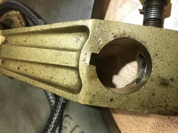

Okay, here are the pics I promised, hope this is what you were after. When you nudge the yoke bolt with a hammer it exposes the crescent shape of the through bolt so the shaft can fall out of the port. Comprehende?
NoWake. Thank you so much for posting that. I have gone so far as to jam two nuts together and try to turn that bolt using the nuts. That’s after I tapped the bolt with a hammer lightly and ruined the threads on it and had to rethread it. I was afraid to hit it hard.
I actually spoke to the folks at Skidim yesterday and after explaining what I had going on, the one I was speaking to pointed me to the image of the bolt on their site and explained how it works. I went to the boat this morning, but a nut on the end of the bolt to protect the threads, gave it a few taps with the hammer and it released.
