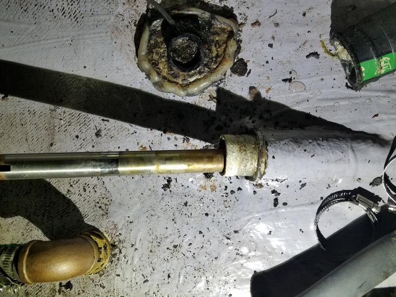

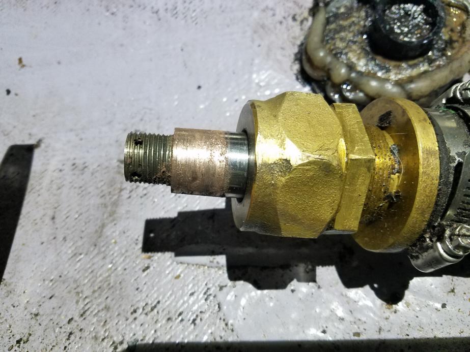

    My '89 Sunsport 351 PCM is at a decision point. We got the bottom repainted and back on the water this week. Top end was terrific and it was happily purring along at 38 mph (last year with scum on bottom WOT was 32ish). Then the drive shaft separated from the coupler. We got it back together and idled home. The coupler and transmission were 3/16" off to port. The drive shaft was clearly to port in the shaft log and the strut seems a little bent. We put a wrench on the motor mounts and they all feel pretty loose. We don't remember hitting anything last year, and worried the soft motor mounts allowed the motor to move. So it seems the inevitable day has arrived.
    We have a local marina looking at it. They has experience with stringer repair and experience aligning bent struts and drives shafts. We should get a quote soon. Ball park over the phone was the expected 4-5k.

    No doubt the engine is misaligned or the strut is bent. After 30 years I would be surprised if it didn't need stringers. You said the engine ran fine the compression numbers are a little low but also pretty even. How many hours do you have on the boat? General propeller is a good place for your shaft repair.

    Boat has 830 hours. Thanks for the recommendation for shaft repair.
