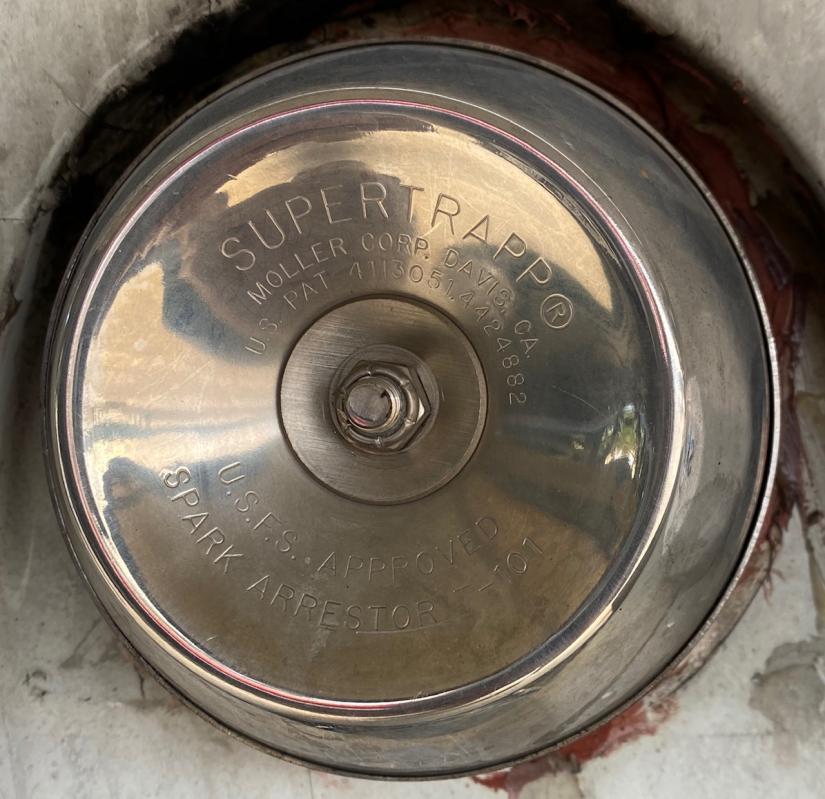

    I have a 1987 Supra SunSport (351). The boat came with SuperTrapp disc mufflers. I have seen these on many of the older boats pictured here on the forum.
    What are the pros/cons of these mufflers (other than making the boat louder, which is a con in my book)? I pulled them off and ran the boat and didn't notice any performance difference, except that it seemed to run a little rich.
    Before I remove the whole assembly -- which is no small task given the amount of adhesive caulk they used -- is there anything else I should consider?

    They sound better than flaps but I don't know that they make more noise. I think it is a prettier, deeper sound than the flaps and if noise is a problem, probably be best to trade for an inboard/ outboard or add mufflers inline. This is a direct drive and motor sits 2 feet away from the driver's seat with straight pipes out the back. That is why people buy these boats.
    Wish I still had the the Trapps on my Rider but they tend to leak into the bilge area which is the only downside to them.

    If you want to remove the Trapps, you are better off taking the rear floor up and removing the entire steel pipe that runs from the rear of the engine all the way to the transom as the Trapps have a bracket welded about four inches forward from the transom and then a long threaded bolt that holds the plates there. I removed mine knowing that I was going to replace the entire exhaust system when I did my restoration.

    the super traps are the only thing that holds the ex pipe in it is a wedge fit if you remove them there is nothing to keep the pipe tight ie water leak
    if you want it louder put stainless washers between the plates to open up the gaps
