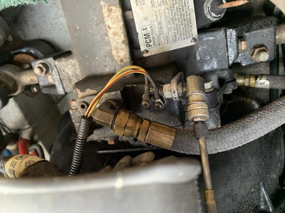

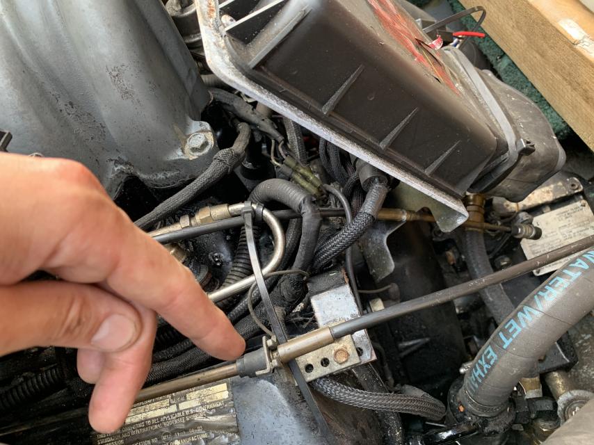

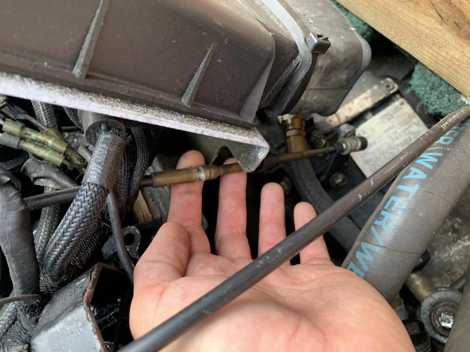

    Thanks Micheal, I checked all parts everything looks ok and the transmission shifted prefect by hand. The cable length looked good the issue that I found hat is causing the problem is that a previous owner or mechanic rigged up the shift line with zip ties and it seems to be missing a bracket that holds the cable in place near the transmission. Any suggestions on rerouting the cable or where a bracket goes for this cable? I have pics of this also pics of the bracket that holds the throttle cable.

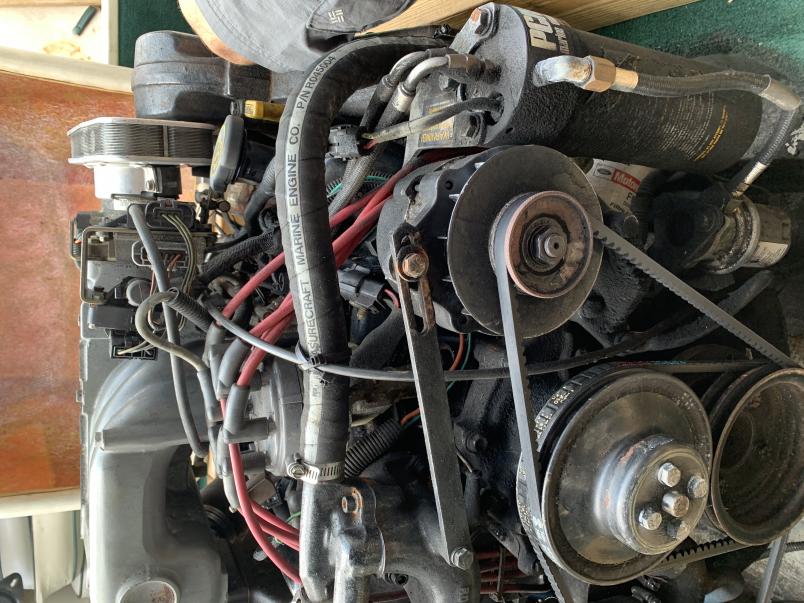

    4
