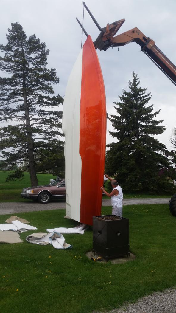

    please don't lift it like i did that was a roll over for paint after a stringer job

    Your picture scared the stuffing out of me till I figured out what was going on! Still scares me! Did you have the cap off at the time of the lift?

    yes the cap was off new stringer were all glassed in
