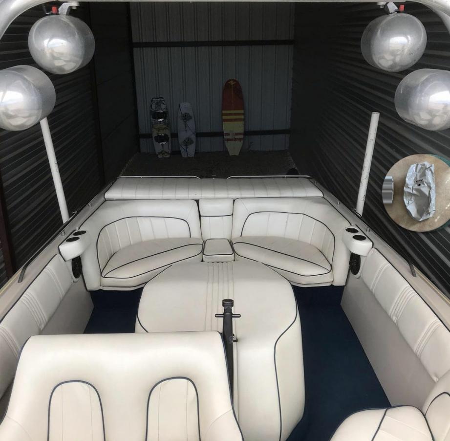

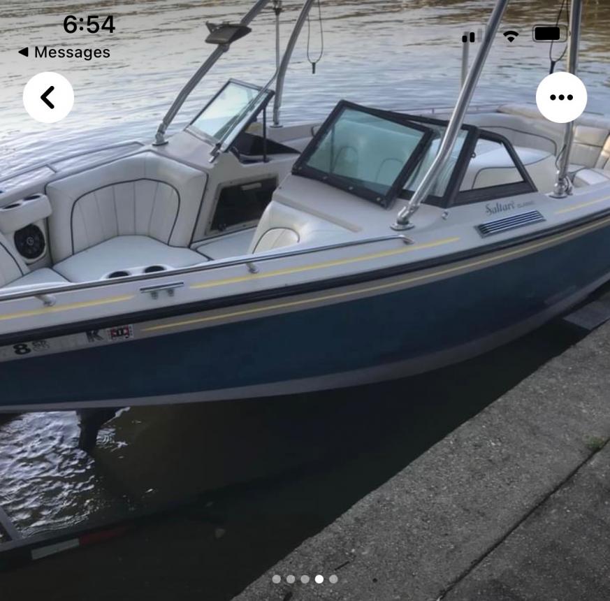

    Long story short I traded a jeep wrangler for a pretty clean 1989 supra saltare. I dont know jack about boats but I consulted with someone who does. It had 472 engine hours and a foot sized soft spot at the aft port seat. Motor sounds great and upholstery looks fantastic.
    All lag bolts spin except for on one motor mount. I read on here about a guy drilling out lag bolt hole. Putting in a epoxy resin and drilling a new hole for lag bolt. I know this is not ideal but for one boating season can it work? I dont want to get stringers replaced and be out of commission for months.
    Does anybody have another option? Through bolts maybe? I will listen to anything a nd everything. Thank you and be kind I'm a virgin.

    That might work if there is anything for the epoxy to adhere to. Definitely worth a try. That is a big boat to do the stringers and floor correctly it will need to have the top cap removed. BIG job but the boat has almost no value the way it is. The boat looks to be in great shape and definitely worth doing. What engine does it have 454 or 351?

    I’d find the best epoxy, concrete or any other hardener that keeps that motor from moving. At this point, what do you have to lose? Just don’t screw up the tranny or the driveshaft.
