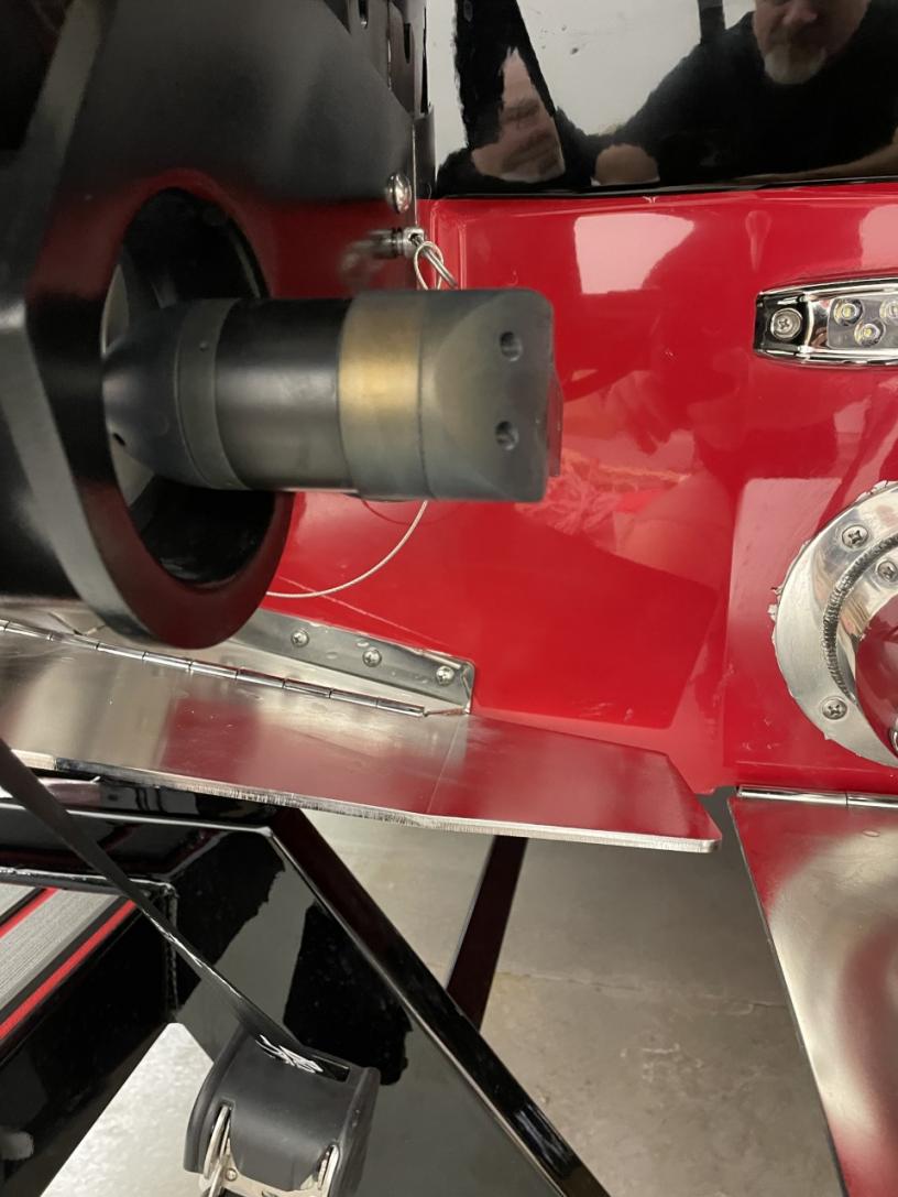

    Still doesn't seem normal to me. Also of note that I pointed out to the dealer, the port side thruster motor is discolored. Turning gold on the motor itself. That isn't happening on the starboard side. He did say that was odd but still assured me that the beeping alarm is normal.

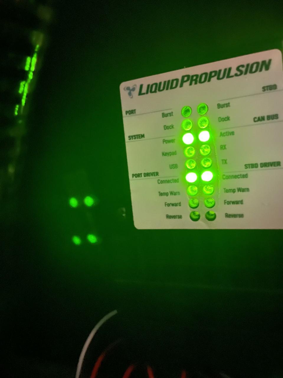

    First off check the control module in the port side of surf locker.
    Looks like this....

    There is a thruster controller on the port and starboard back seats, when boat is powered, those cooling fans will run. Thrusters use a ton of power to run.

    Also I cannot find the control panel from your picture. I took off the panel in my rear locker and mine is the pictured control panel with the cooling fan. There is one of those on each side.

    On my SA itís in the SURF/rear locker tucked up to the starboard side (I said port before, my apologies)of the engine access panel.
    Itís out in the open, no cover over it. You kinda need to stick your head in locker and look up.

    The discoloration seems wrong. My guess is the beep will show a red light fault on the controller.

    I did find the control module you were talking about and it doesn't show any red lights.
