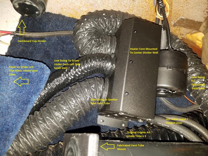

    I made my own for my Saltare. Foudn teh biggest off the shelf heater core I could (I believe it was for a '79 Ramcharger) and made a box. Welded 2x 4" tings on teh back for blower motors to push air through it, and 3x 3" rings on the front for the hot tubes. Piece of cake. Kept the in/out low on the box how I mounter it so winterizing is easy, but disconnect the hoses from intake and suction side fo raw water pump and blow through the hose until nothing comes out. Seat heaters are a great addition too!

    I want to say it was about $156.21, as per my thread here: https://forum.supraboats.com/showthr...-homemade-heat
    Probably $200-ish if I ever add pull out "hot tubes" rather than jamming blower hose up my shirt or pants. I checked RockAuto and AUtozone, 1980 RamCharger heater cores for no air conditioning seem to be NLA... Better take care of mine. There are other slightly smaller heater cores available for about $30 so there are options when custom making. For me to make these there wouldn't be enough money in it, I could make the design better doing it again, but I'd be around the same price at off the shelf heaters for maybe a slightly bigger heater.
