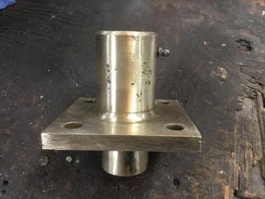

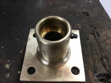

    Will have one available soon. Cutting up a 87 Ts6m for parts. Check General Chat Section for pics. Thanks, Kevin My rudder port from the Ts6m (1987) has 2 - 340815 National seals under the snap ring and a #216 o-ring at the bottom. Seals are 1.494” bore size, 1.505” seal o.d., .25” thickness. O-ring is 1.375”(1&3/8”) o.d., 1.125”(1&1/8”) I.d., .135”(1/8”) cross section(thickness). Hope this helps as these seals are commonly available.
