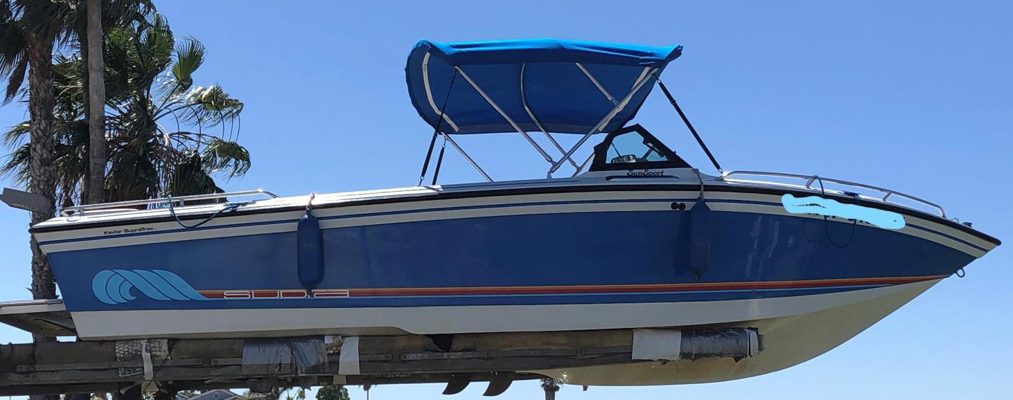

    15. Largest Size OEM Reproduced Wave Decal ebay halledc Halledc is a poster here, and he worked with me to create the exact size wave decal. He's on ebay and as you can see from the photo, it really looks original. Great work Halledc!
    16. VDO Gauge Clock 370-155 2 1/16” / 52MM 12 / 24 dual system ebay They don't make the original, of course, but this is good enough.
    17. Sierra MP 39770 # Position 1 1/8 Polyester 3 Blade Terminal 12 15 A amazon
    18. Waterproof Boot Nut 1 PM 39190 for ignition switch ebay
    Below is a closeup of his wave sticker. Also, look carefully in the chrome intake. Can you spot the GPS sensor wedged in the grill? [Hint, it's under the "t".]
