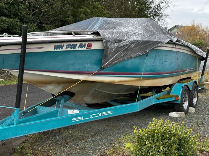

Original Supra trailers were made by a company called SMP (Sweetwater Metal Products) There really is no information on them.

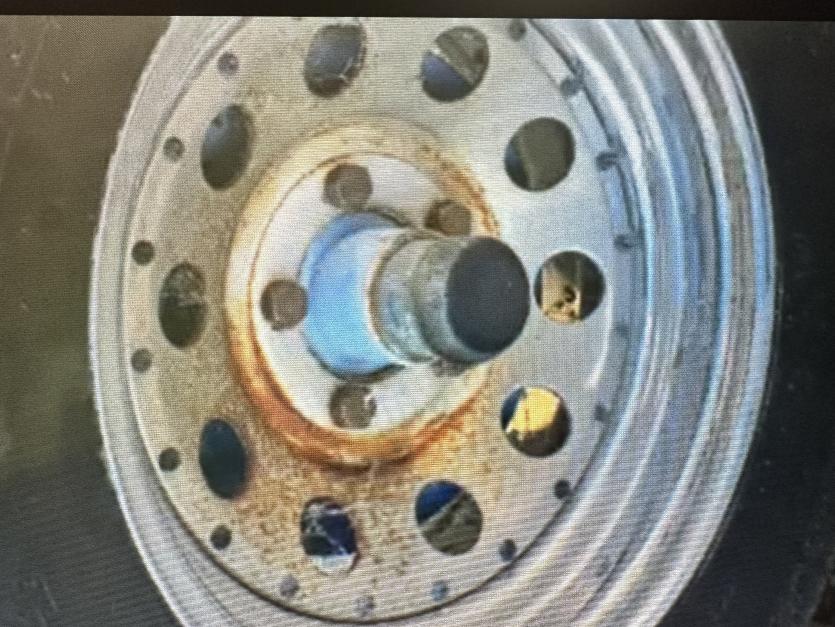

What you have on your trailer is pretty standard still today but yes, you will have to figure out what size you have. Most of my SMP trailers have 14 inch rims from factory with 5 lug, 4.5 bolt circle diameter. Tires are ST205/75R-14
Your bearings and races should have numbers on them once you take them out and clean. Just replace with identical.
Here is information off my '83 SMP trailer.
Inner Bearing number - L68149 $9.99 @ Northern
Inner Race number - 68111 $7.69 Napa Auto Parts
Outer Bearing number - L44649 $12.99 O’Reilly Auto Parts
Outer Race number - L44610 $5.99 @ O’Reilly Auto Parts
Grease seal - National #473317 $14.99 O’Reilly Auto Parts
Inner Diameter, 1.687”
Outer Diameter, 2.325”
