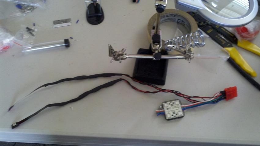

    Haven't been able to get out lately - tweaked my old back injury while on family vacation. However, I was able to finish one more project - the RGB LED interior lights are up and running.
    I pre-wired harnesses for each of the speaker pods. Each harness has two surface mount, waterproof, RGB's from Oznium for under each cupholder and one 4 light, waterproof, RGB module from EcoLights mounted facing down in the original courtesy light location. I wired each harness with a 4 pin connector so that I can easily unbolt and unplug the speaker/cupholder pods if needed.
    I cut the backs out of some standard trunion bulb stern lights to replace the original courtesy lights, so I have a nice clear lens and s/s trim ring to finish it off. I also added one of the EcoLight modules and trim lens/ring to the panel below the walk-thru by the ice chest. I did not put one in the helm cupholder since I thought the glare/reflection off of the tinted window would be too distracting.
    I wired all the lights to an RGB controller mounted up under the helm with a remote that controls the 13 different modes (solid colors, fades with adjustable speed/brightness, and 2 audio modes). I took two of the speaker level outputs from the head unit through a Stinger line level converter as the audio inputs to the controller.
    The effect is pretty cool - I can change the color to suit the mood, or the kids love the full on disco. A neat feature of the audio modes is that the brightness is varied with the volume in addition to changing colors with the beat. The reflection in the new s/s cupholders is more subdued than the RGB rings, but looks really cool with a bottled beverage of choice installed.
    All I have is this crappy cell phone video, but you get the idea... http://youtu.be/FqjKbk3D6HU

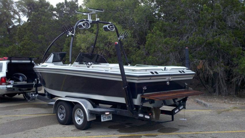

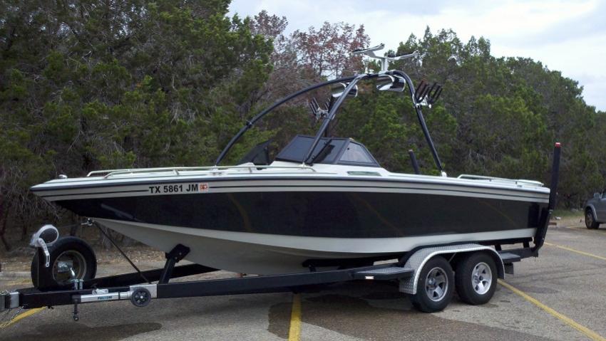

    Oh yeah, just to keep my pics in a common thread - here's with the tower installed. Getting better - takes me, wife, & 1 kid 5 minutes to get the front wishbone installed (sadly everytime in/out of garage - no header clearance.
    Not sure the RGB LED link worked in previous post, but think this works?? http://youtu.be/FqjKbk3D6HU
