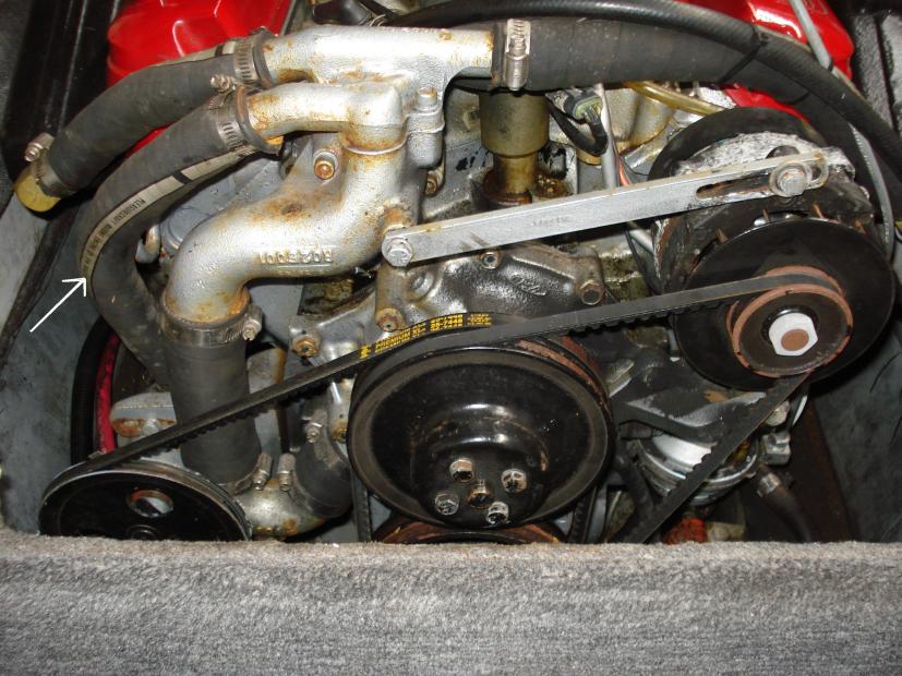

    Filling with Anti-freez.....by doing this, are u taking ur intake hose off, and pouring into there and turning ur motor over? I have a feeling someone is gonna smack me in a minute....

    You pour the antifreeze through the upper hose on the raw water pump. Bend the hose up and pour in 3-4 gallons until you hear it coming out the exhaust. No need to run the motor. It will flow past the thermostat as long as all the water is out of it.
