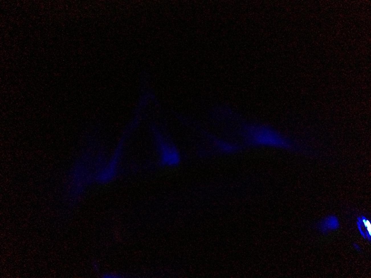

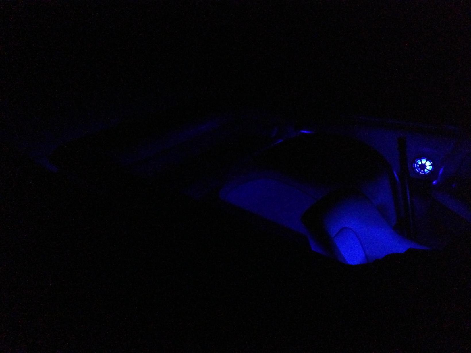

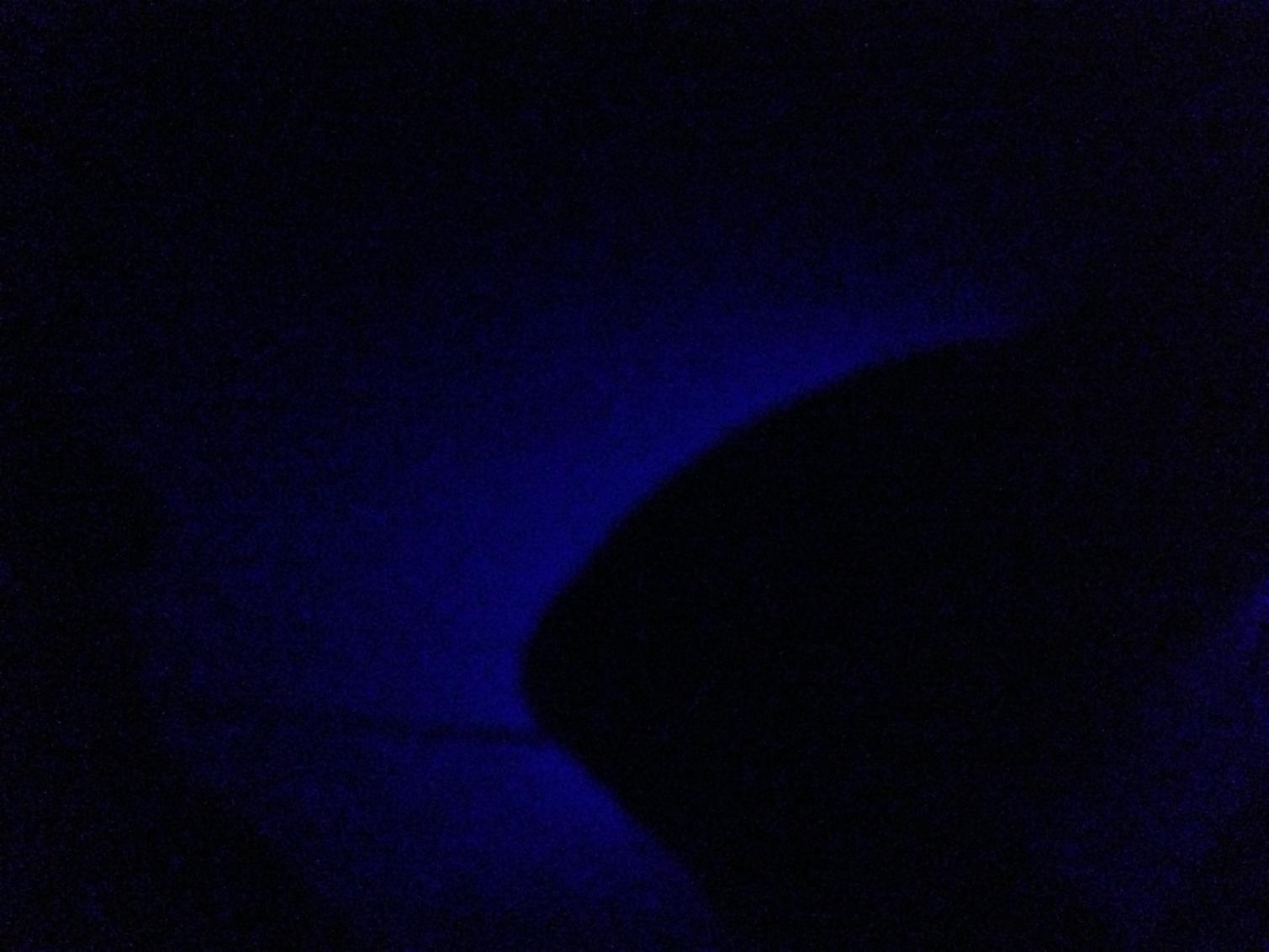

I put two in. I have a third made that I may add over the winter. I mounted them between the exhaust flaps and the mounts for te swim deck. Getting the wires up is a pita. I had to take the blower covers off and reach down to pull them up over the gas tank then feed them over the tank to the wire tube then hooked them to my kicker speakers that have LEDs built into them. The one thing that annoys me is that back factory light that is clear. Thinking about getting a blue bulb for that also. Does anyone know what type bulb goes in there. It's the one that's in the center of the transom. Comes on with the from nav light.
