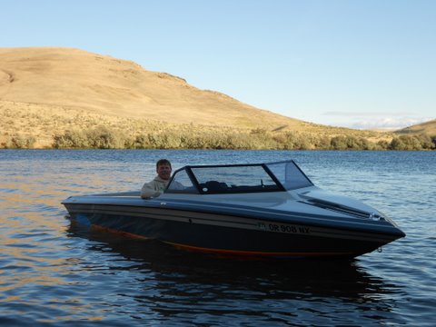

I've been watching thread from the start you and your wife have done a grate job bring anther one of these classic boats back to life. She is good for at least 30 or more years. I hope when it comes time to let her go you can find her a new new home with an owner that will take care of her and love her like most of us on this forum would.Attachment 15361
